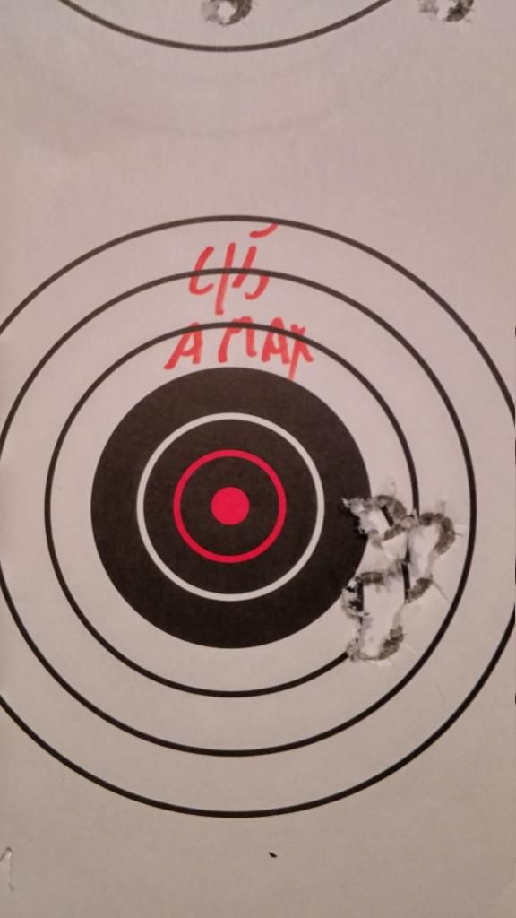

A bunch of people will rag on the Archangel and tell you the option is worthless unless you spend 2K on it, but my R700 shoots pretty darn good in one (AA700B) and it doesn't cost 4X your base rifle. It uses M14 mags, free floats, beds the action and is completely adjustable. The only downside is the built in bipod sucks. I screwed a piece of picatinny rail over it and put a standard bipod on it.
