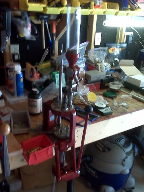

I had a dillon 550..never really "liked" it. I already had a Rockchucker with the Hornady lock and load bushings so I sold the Dillon and bought the LnL AP press. All my dies now drop right in without having to remove bushings etc..
I loaded over 400 7.62x51 in little over 2 hours. That may seem low but it was the first time I had used it and I had some learning curves and was watching what to tweak as I went along.
For whatever reason the Hornady really works for me whereas I never warmed up to the Dillon (and I had it for 5+ years).

I love my RED Loadmaster, just got it the other night, took about an hour and about 7 ruined pieces of brass to get it dialed in just right. Loading 9mm right now, have already done about 250 in about an hour and a half, and have the parts on order for .223 loading. Very Happy! and I don't know what 'those' blues ones run for but the loadmaster new is $275 and the pro 1000 about $175 shipped.

For the $, the best progressive press is the Hornady LNL. We could go on all day about which press is the absolute best, or which company offers the best customer service, or which color looks best with your decorating scheme, but you can't argue with the bottom line.
When you factor in the free bullet promotion, you can almost buy two auto-indexing LNL's for the price of one auto-indexing 650. You could leave one set for large primers and one set for small primers, and do caliber changes in less time than it takes to walk upstairs for another cup of coffee.
