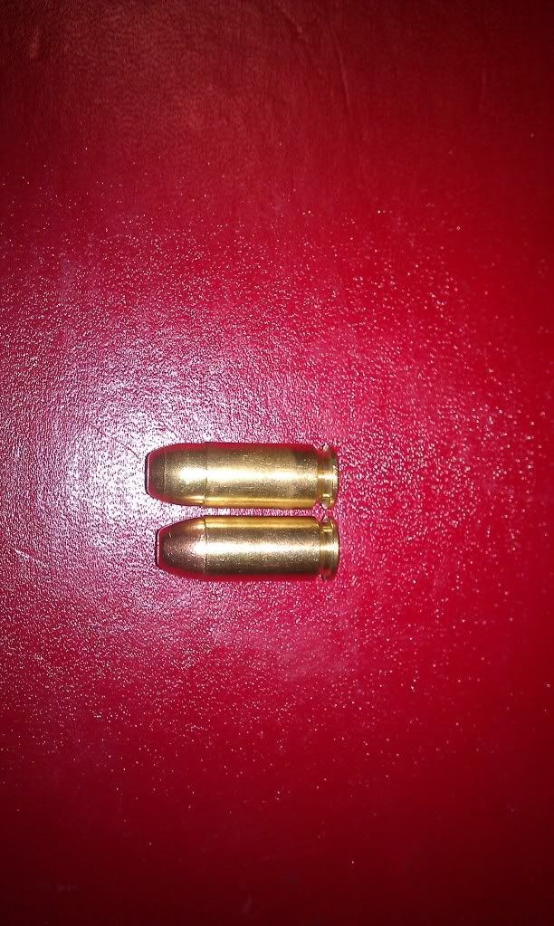

I'm looking for the guy that was selling reloaded ammo at that show. He was about one aisle over from JT with Paracord Joe's. I bought 500 rounds of .40 and I can't shoot them, they aren't sized right. I don't have any contact info for him. I'm hoping someone knows him?

Do you have your own reloading setup? If it was me I'd just seat them right and fire away.
Or find the guy and get my dang money back!
Without knowing the powder and charge he used to load the ammo that could be dangerous. One can assume that these are loaded with an appropriate powder and charge for plinking and that they aren't sensitive to seating depth of the bullet........but that's a pretty big assumption when youre the one behind the trigger........

Umm... before doing that, I'd pull at least one to make sure it's not an overcharge condition and maybe have a chance of identifing what kind of powder was being used. I'd be wary, just to be cautious.
Yeah I was thinking the same thing. Probably better off selling them as components.
But I've heard to people loading 40sw long, for use in 10mm guns with a conversion barrel.
If the powder charge is correct though, seating it to the correct OAL will not hurt anything. If he mixed up the powder charge, he shouldn't have been selling reloaded ammo at all.

Bad 40 S/W ammo

That doesn't make any sense. Any 40S&W round that is too long is not going to chamber in a 40S&W barrel, whether it is a conversion barrel or not. It doesn't matter what the gun platform is.
What he was saying is that it did not fit the guys 40 cal mag but will fit in the 10 mm mag.
I did not read that he tried to chamber a round and fire it.
Many Match rounds for rifles may be too long to fit the mags but will fit in a chamber.
My PSS 223 and 308 are that way and also some of my handguns. The gun will shoot better with the round seated out more but will not feed in the action or mag.
I have two sets of rounds for my Henry 44-40 that I shoot for matches, one is slow fire loaded way out, other loaded to work in the lever action for the speed shooting.
Same with the 45-70....
Ya, I would pull em and reload them myself... No way I would trust the powder on those if he managed to screw up the OAL that way.
I have never trusted reloads in the 40/10mm due to the fact they are loaded with the same powders (type), and same dies for both, just change the depth.... If he screwed up the OAL then did he remember to change the powder to match the 40, or 10mm?
