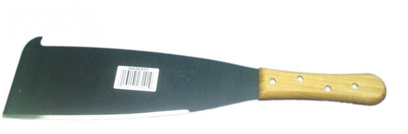

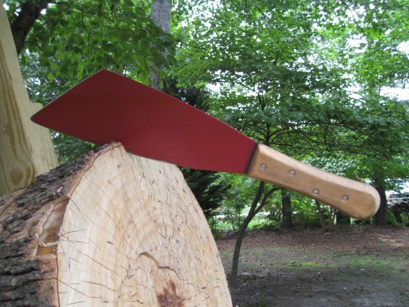

Little fun project today....I took a 14" Tramontina Cane machete and cut, reprofiled and sharpened the blade and then spray painted the blade. The leading edge is also sharpened now. It's a wicked bush cutter and general hacker.
It makes a fun thrower also and throws and sticks like a Hawk.
