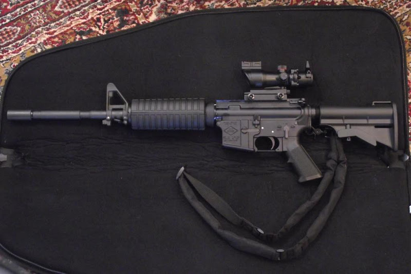

There was a thread here in the dealers section early in the year about this new AR manufacturer that wasn't too complimentary. Most negative comments were tempered with the fact that they were just starting to make ARs and should have done some beta testing first. "Teething pains", if you will. Well now I find one of these fine rifles in my possession, lol, having been unable to turn down a brand new AR for $579 at the gun show yesterday. The guy had been selling therm for $600 and this was his last one on Sunday afternoon.
I admit I didn't know a lot about the company but one of the selling points for me is that they are right at my back door and if I did have any issues I imagine I could get them taken care of. Haven't shot it yet, but assuming it goes bang I think I'm happy with the purchase. It's about as bare bones as you can get for a flattop m4 but it does have a 1/7 twist for the heavier rounds which I like. So the point of this thread is for me to ask does anyone have any updated info as to whether or not they have gotten their act together and now produce a quality product? I'd love to hear. Regardless I'll post my impressions when I get a chance to sling some lead with it.
Obligatory pic (sling, ACOG knock-off, and Levang comp are my doing):
The trigger pins appear "shiny" are they stainless ? If so I'd get another set as I have seen nothing but issues with them... they had hardness issues etc.... is the barrel / chamber chrome lined ? Do you know who made the barrel ?
I was told it was not chrome lined and I didn't expect it to be at that price. It has no visible markings.
The finish on the barrel is somewhat strange to me though. It's uniform, but is a fine abrasive gray that starts to appear powdery if dry. If you rub it with your hands or a cloth when dry it will get powdery which seems like its tiny bits of skin or cloth. Maybe I'm just not used to parkerizing of this type.

Also,what kind of goofy-ass stock is that? Looks like a mix of Old Fiberlite and M4. Judging by the latch, the locking pin is either too long and the latch would rattle around, or you dont have it collasped all the way. Is that a muzzle cover over the FH?
The "muzzle cover" is probably a Levang linear compensator based on his first post.
